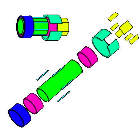

Here is a structural break down of what I used to build the engine master:
Because I will be referring to different sizes, I have color coded this passage to match with the diagram. The green tube is a length of Plastruct's TB-24 piping, which is measured at 19mm outside diameter. The pink is TB-28 tubing and measures at 22mm. The blue, which slips around the forward most length of TB-28, is a segment of TB-32 and is the largest piece of Plastructs inventory of piping I've needed to order yet. It measures in at 25mm outer diameter. The sea foam green 'C' is a wrap of textured plastic from EverGreen's assortment. The precise one I used in this case is listed as E-5 '4529' "Metal Siding" and is sold in sheets of 100 square inches. Apply a little bit of heat and it becomes pliable and can simply be glued into the length of TB-28.
The floating yellow squares are just panels of .5mm thick styrene I cut and glued to the last section of exposed TB-24. The teal length between the segments of TB-28 are simply lengths of 1mm thick Hex-rod. Plastruct's got these listed as MRX-60. I also got .1mm lengths of these hex rods to become the bolts on the sides of the engine you see in the finished product.
And that's the breakdown of how I built the master for the back half of the engine.
