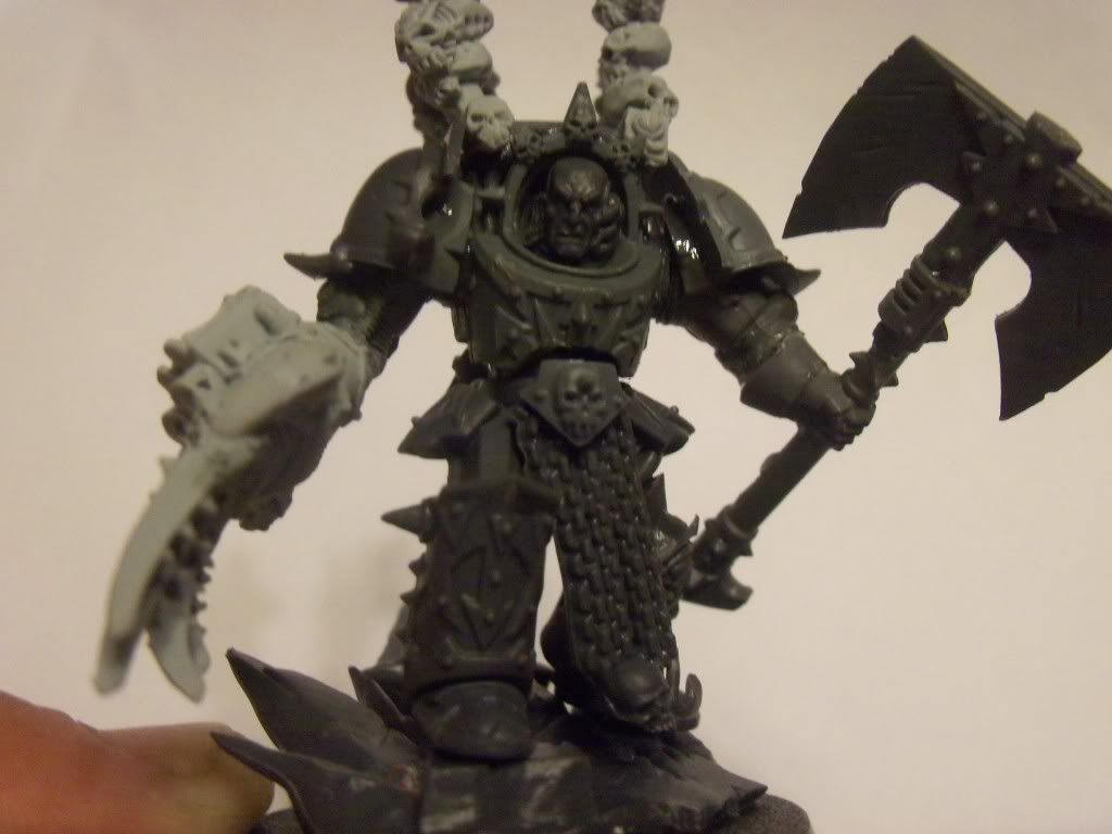

First and foremost.. TASTY CONVERSION ! Being an avid converter myself I applaud you and your wonderful addition to our beloved hobby. I am tempted to take your idea and make it my own, with my own FFX twist to it. I've been looking for an idea for a Khorne Lord in Terminator armor and you sir have given me a solid base to work from. I have the Zhufor mini but he's not quite what I'm looking for. I'm inclined to build a menacing chain axe in the hand that holds the Demon Sword and keep the Talon of Horus. I am a firm believer that imitation is the most sincere form of flattery. I'll post up my version of your conversion once I get around to it.

Well speeking of Khorn Lords i converted one from the Terminator Lord model cutting the hammer parts off of a plastic Thunder Hammer to make a double headed chain ax type Daemon Weapon. Then i cut the axe parts off of 2 Khorn Chain Axes from the Berzerker sprue. I then filed down the back ends of the ax heads so that they were flat enuff to glue onto the Thunder Hammer shaft. After that was done i glued the arm into place. I then took the Buzz Saw arm from the Ork Nobs sprue and glued it on just to make him look like the sick nasty killing basterd that he is.
Sounds rather labor intensive, which is fine. However I'm leaning towards using the rather large chainaxe heads off of the new Ork Nobs. They're great for Khorne Conversions, and plastic so I love them. I used them on my Beastzerker Champions.

Ask and you shall receive.
FFX
