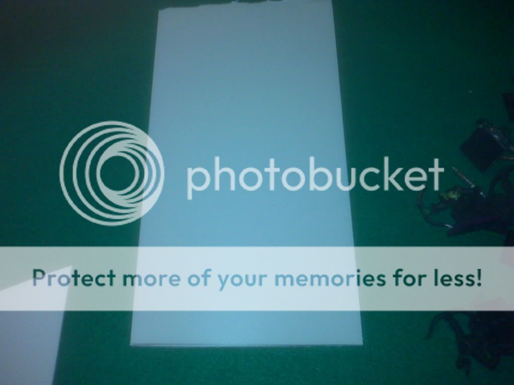

Our gaming club has not river terrain (or water at all for that matter). With the release of 8th edition, river terrain is pretty cool to use (and my skinks can swim through it:laugh:). Anyway, I decided that I would make some terrain for our club to use. Here are some pictures. This is just the beginning. I need to paint these as well as base them. Enjoy!
The plasticard before cuts (My wife sometimes gets tons of this stuff FREE!):

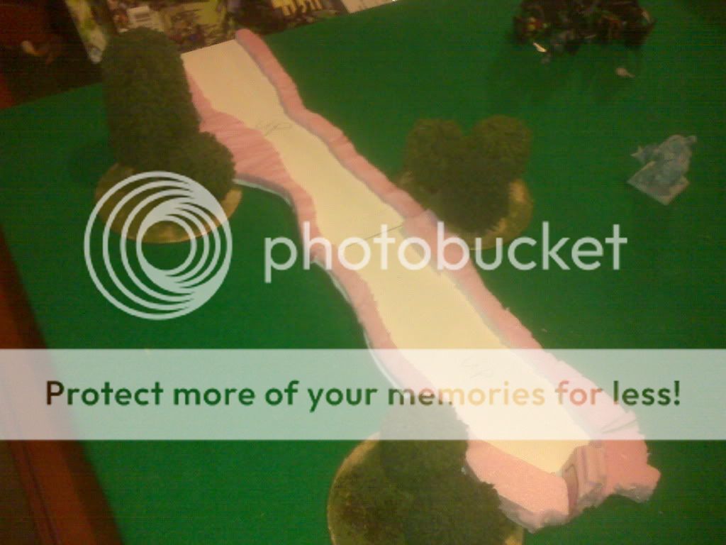

Next is a river from the edge into an end piece with some trees around it for scale:

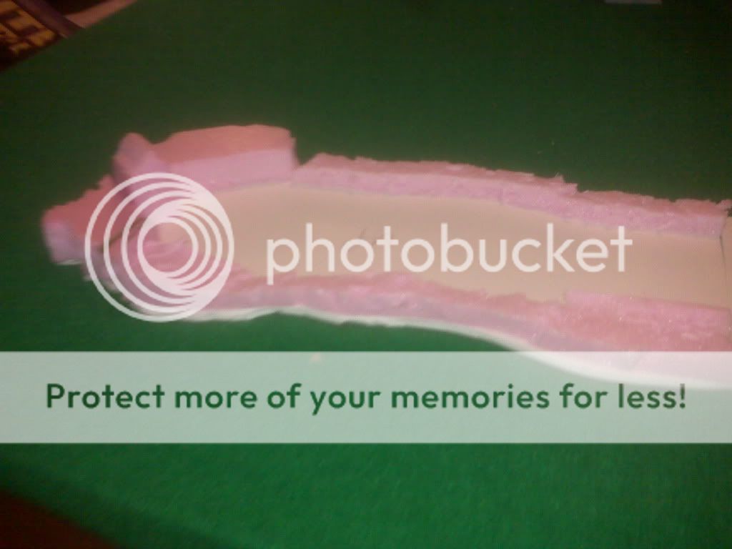

Now an end piece without the rocks:
And one with the rocks/bank:

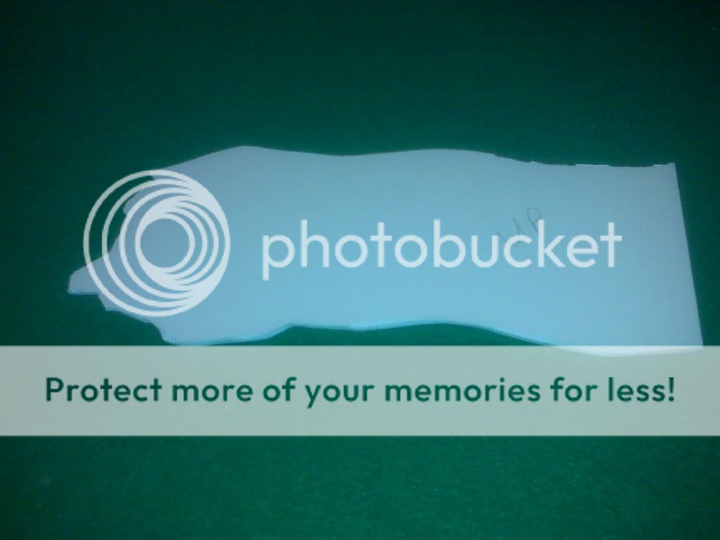

I have some angles cut as well and plan on cutting out some 45 degree turns as well.
