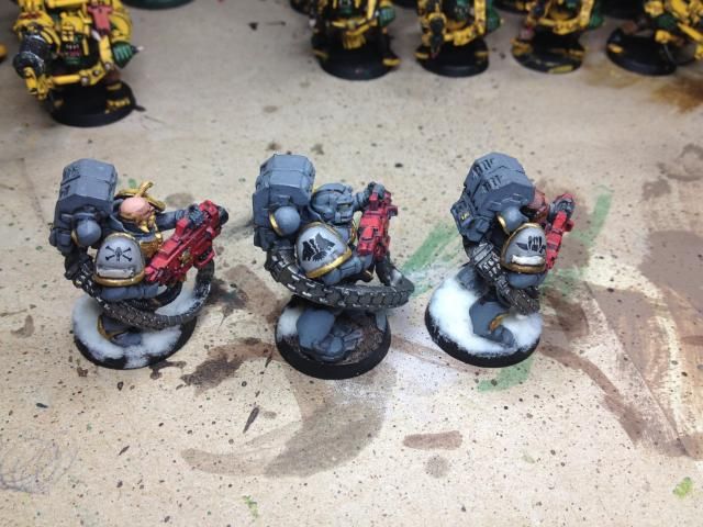

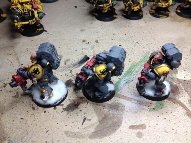

I use Rejuvenate Floor Restorer Protectant, but I'm pretty sure any floor polish will work. It's basically polyurethane. For shoulder pads I put a little on the shoulder pad and then float my decal on. I let the floor polish cure a little and then put a little more on. I am basically trapping the decal between two thin layers of polyurethane; a little matt coat once it dries and you're done.

Examples of Rejuvenation Floor Polish Decals
im intrigued by this. Can you show any examples of doing it this way? like a few WIP shots? i want to see how it compares to the traditional method for doing this.
I can take a few snap shots of finished models, if that's ok... I'm not working on anybody in power armor at the moment.
Long Fangs - Right
Long Fangs - Left
